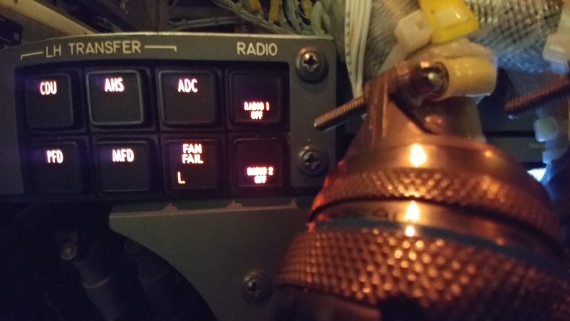

Hawker 900EX with the left equipment cooling fan indicated as failed.

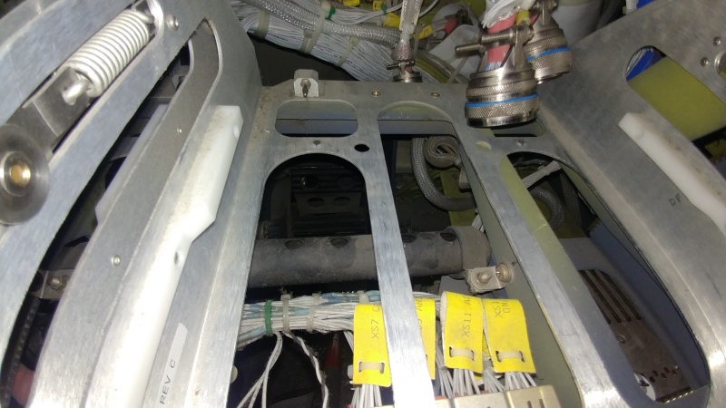

With the multifunction displays removed, there was a large amount of air coming from the piccolo tube located below the display racks.

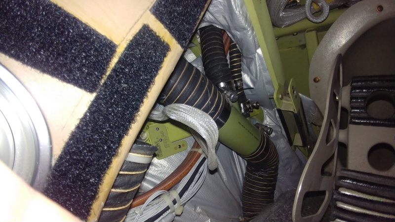

With the lower side-wall pulled off, it could be seen that the air from the cooling fan was split into three user systems. The large tube going to an adjustable vent for the crew (L/H vent), the mid-sized tube going to the multifunction displays, and the small tube routed to the glare-shield.

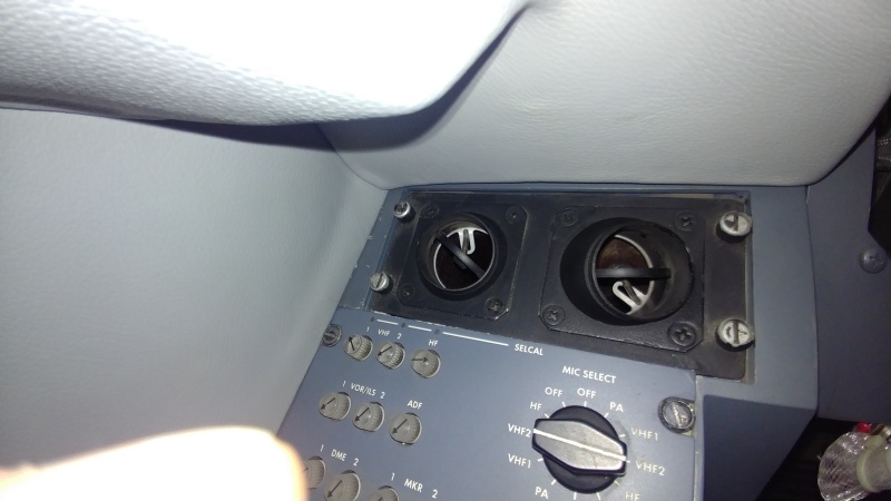

The weird issue with this particular failure was that the fan output was strong. We could clear the failure by just opening up the crew adjustable vent. With the vent closed, the failure would reappear. Corresponding air flow from both the other outlets would increase with the pilot vent closed. All functions seemed perfectly normal.

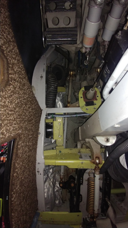

The fan assembly is below the floor, just outboard of the control yoke column.

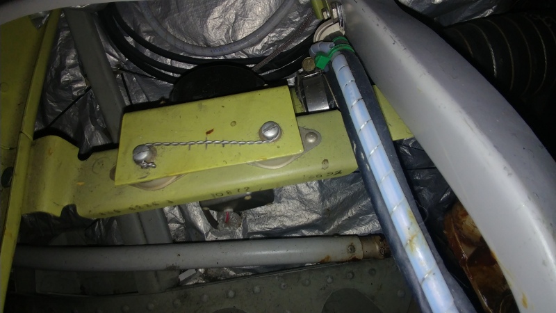

Fan (only the sensor wiring can be seen from this angle).
