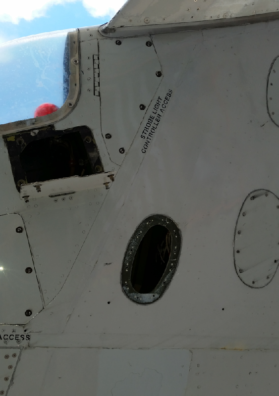

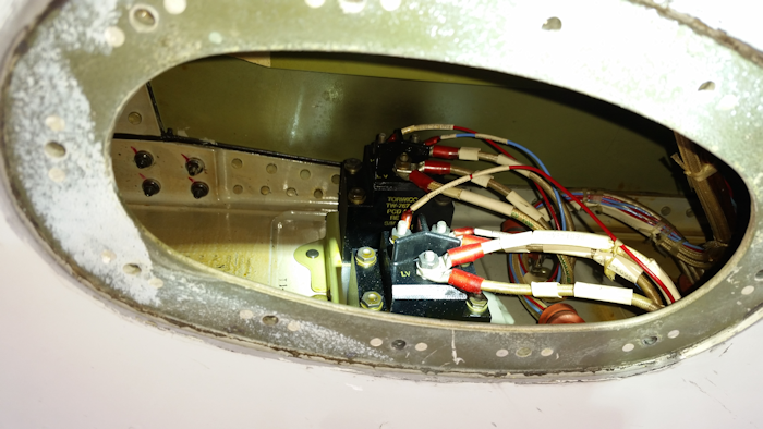

Just for the fact that we dropped 4 panels before we found the nav light transformers...... a couple pics might help prevent others from doing the same.
These function to drop 115VAC down to 10 VAC to power the navigation lights. One transformer each for one forward and one aft light. Basic troubleshooting....... if both lights are on, either forward or aft, the transformers are "not" your problem.
