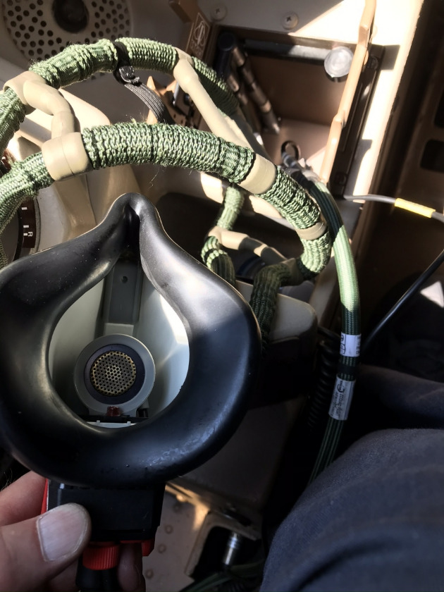

The only image I have is:
The FedEx aircraft that I worked on had full-face masks that covered both the mouth and eyes. I've only seen these on FedEx aircraft. They were not available in the jump-seat positions.

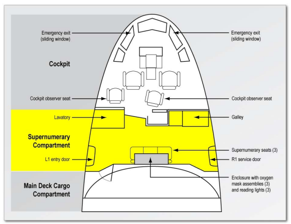

I could be wrong on the Supernumerary area on passenger jets. I don't work on people haulers, but I did find this image on the internet. Possibly the front galley, lav, and attendant seats would considered the supernumerary???
Of the planes I've flown on, I've never seen the box oxy masks in this area.

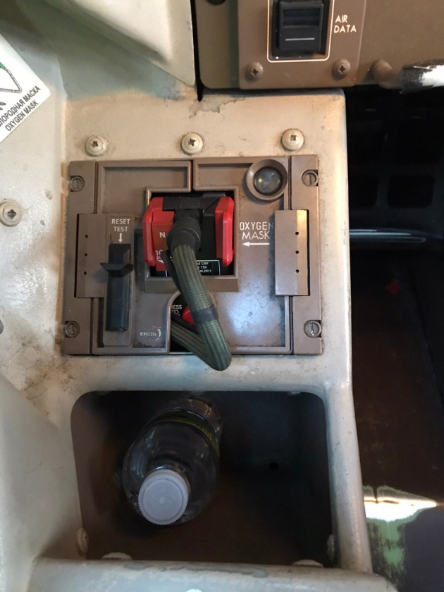

3 years 8 months ago #864 by Mark
Replied by Mark on topic B737-300/oxygen system

3 years 8 months ago #866 by Mark
All oxygen masks in cockpit would be the box mount type.
I haven't seen otherwise.
3 years 8 months ago #867 by dynamics
Replied by dynamics on topic B737-300/oxygen system
My apology for the confusion, what I was asking is whether the last photo that you sent is corresponding to observer mask in b737-300?
3 years 8 months ago #868 by Mark
I don't have access to 737's.
This should be the same box though.
Even for observer.
