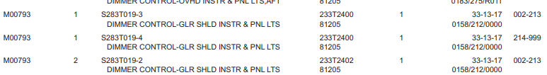

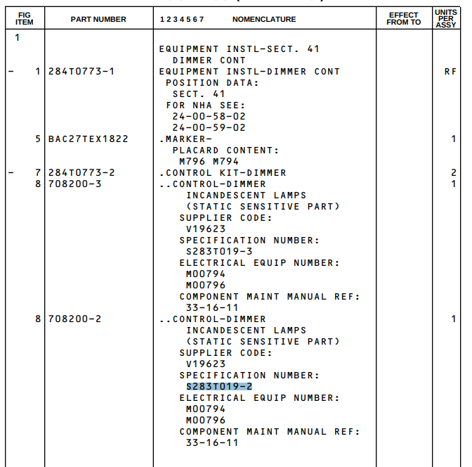

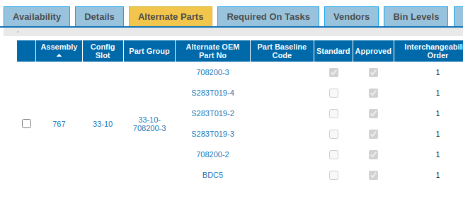

As an example: Light Dimmer M00793.
The equipment list part number:
The IPC:
My company's parts search results:
As you can see, several part numbers are listed in the Equipment List. A completely different number is shown in the IPC. My company's parts data base shows numerous interchangeable parts.
