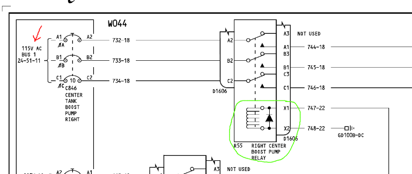

Mark, regarding to engine feed boost pump wiring diagram I' ve emailed attached, would you mind explain why there is not any comparator circuit (to detect ground leakage from comparing the amount of current going and returning) for relays R20&R55 which act as ground fault interrupter (GFI)?

The relays mentioned do not act as a GFI. The way they are drawn it looks like they might have that function, but they don't.
The diode in the relay itself is a suppression diode as explained  here .
Actual current protection occurs further upstream from the 3-phase breaker for the pump.

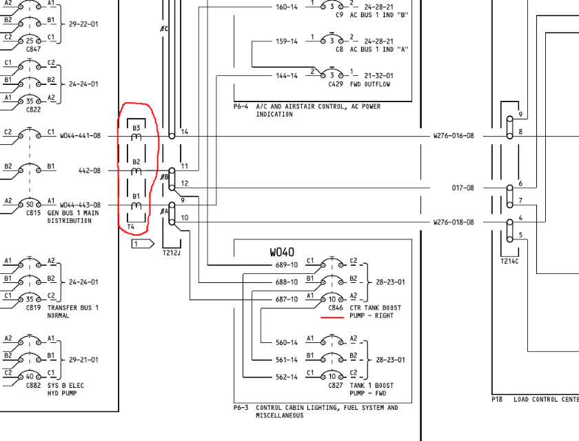

In this case, CT (T4) is the load side sensing device for the whole "Gen Bus 1 Main Distribution" power bus. There will be another current transformer on the feed side (usually close to the generator output) that the Bus Protection Unit compares amperage loads.

The circuit breaker C846 should pop open if one leg of the pump power goes short to ground.
Fuel pumps "can" run on two phases, but they get hot. Some pumps have a thermal switch which kills power to the pump itself.
I do not know the current difference that the Bus Control Unit uses as limits for a disconnect. This fuel pump breaker is 10 amps. I would guess the disconnect threshold is higher which is why I think the breaker is the main source of protection for a fuel pump.
