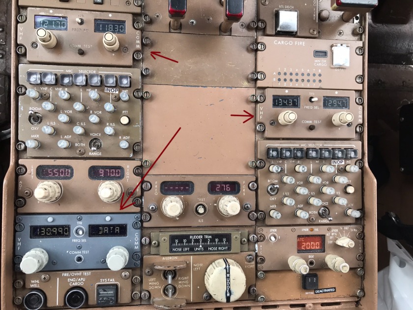

3 years 5 months ago #985 by Mark
Replied by Mark on topic VDL/HFDL

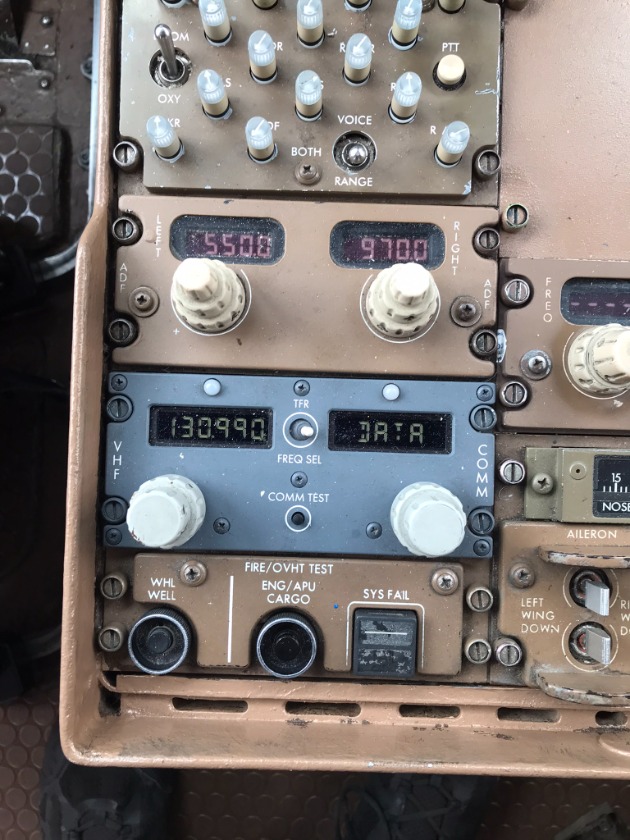

Three Comm Tuning Panels. Left and right, voice. Center, data.
The center can be voice or data. This one selected to data. Normally in data 100% of the time.

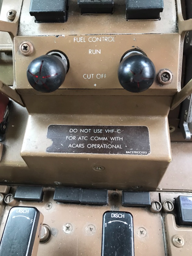

Center VHF note to crew under the fuel shutoff levers.

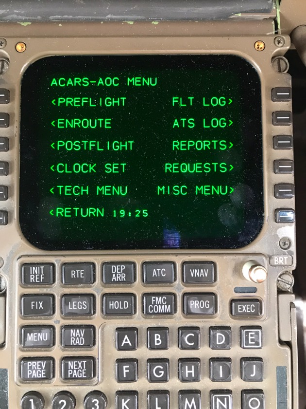

ACARS menu on Flight Management System CDU.
