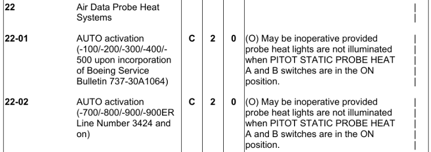

With regard to FAA AD 2022-24-09 paragraph h, it is necessary to include specific operation procedure for flying at or below 10000 feet with inoperative altitude pressure warning switch, however I can not found specific operation requirement (O) for inoperative cabin altitude warning system for 737-300 model as per MMEL?!

3 years 5 months ago - 3 years 5 months ago #1026 by dynamics
I emailed the service bulletin regarding automation of heating system of air data probe and the MMEL(ch79/04-01)

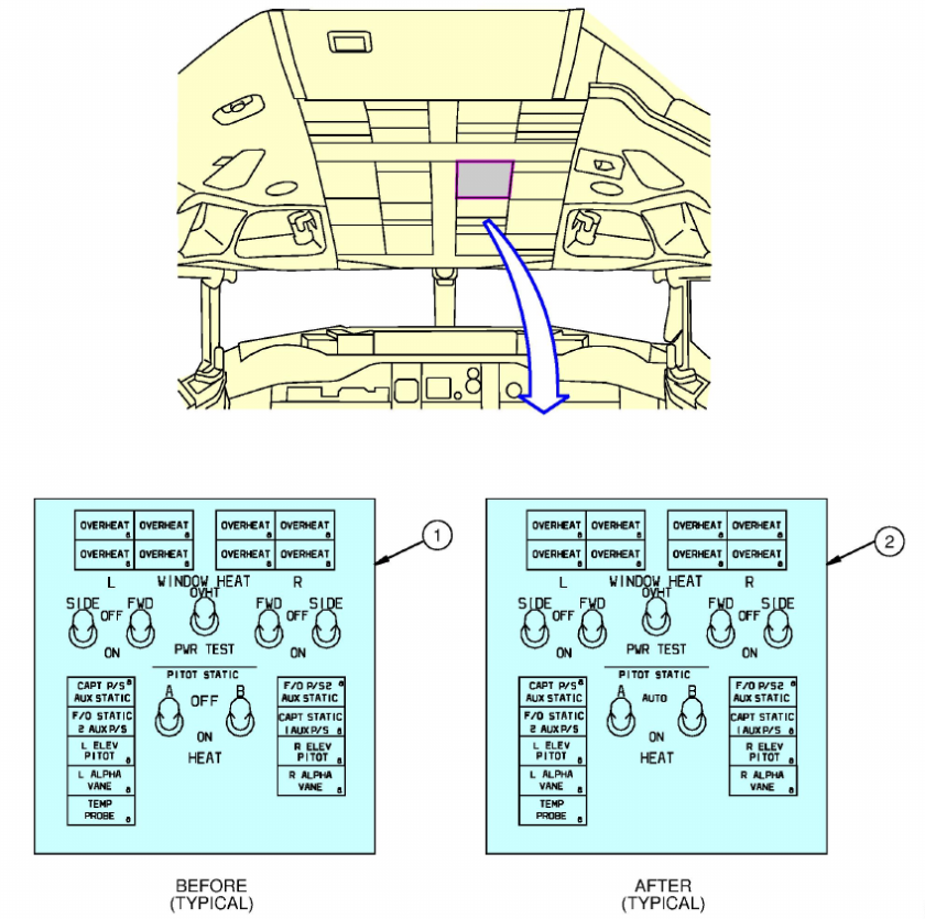

Do your Pitot/Static control panels have a Off/Auto/On switch?

I see it now.....

Did you look to see if your aircraft have the panel with "Auto" on them?
If one does, then you need to send me the prints for that effectivity aircraft.
