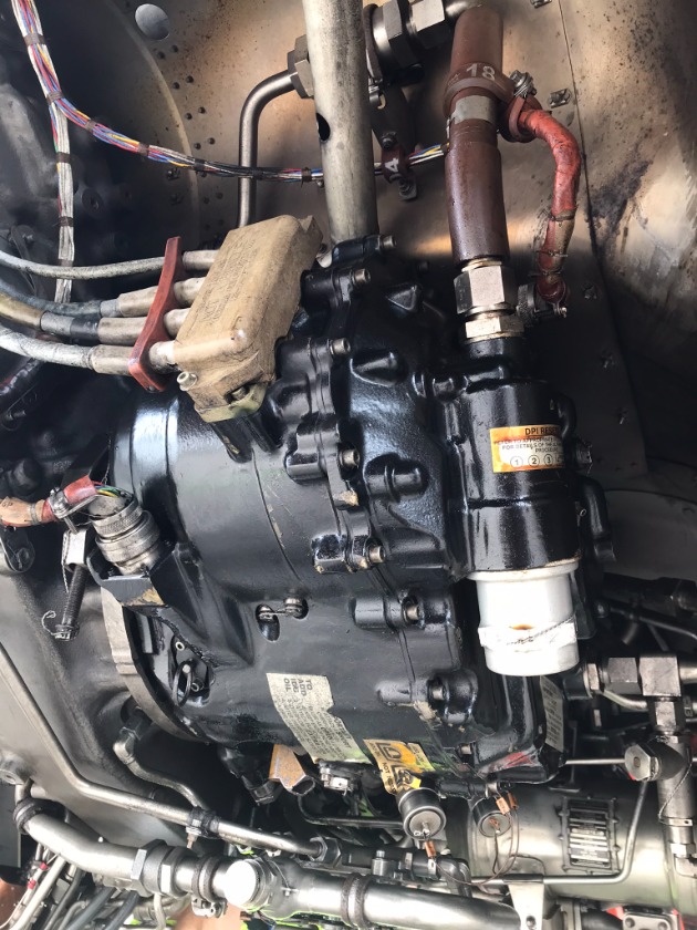

3 years 5 months ago - 3 years 5 months ago #1022 by Mark
Replied by Mark on topic AC Generator Overhaul
IDG
CSD section mounted to gear box. Generator section basically mounted on the side. This is one unit with two functions and it is removed/installed whole.
