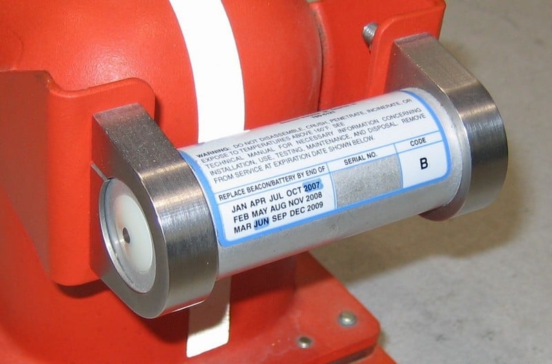

The ULB battery is a water activated device. It uses water as a conductor between the outer band and center contact to complete the circuit.
To activate for test, we use a small piece of wire mesh between the two contact points.
We've been installing larger ULB's attached to aircraft frame next to the recorders. The battery is larger and the beacon "pings" at a ≈1/3 slower rate. These are being used on ETOPS (extended range aircraft). I'm sure this addition is in response to Air France 447 which crashed into the Atlantic. The recorder ULB batteries ran out of battery power before the aircraft was located.

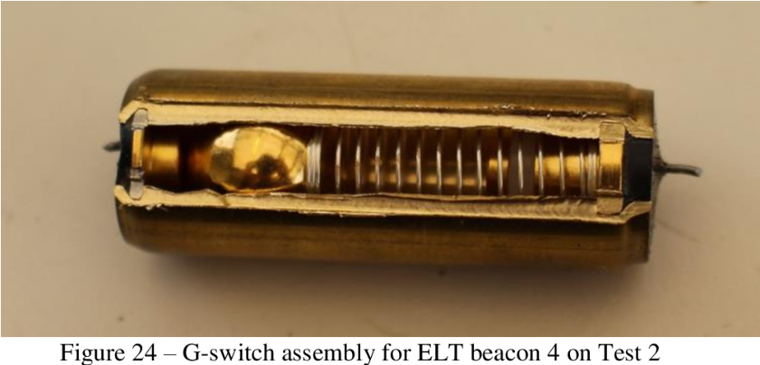

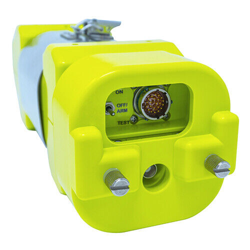

The ELT uses a "G" switch to activate the unit. It can also be turned on manually.

Mark, taking into account all available commercial products which may be used as ULB battery, would you mind tell me how much the battery cost on average?
3 years 5 months ago #1056 by Mark
Replied by Mark on topic ULB/ELT
I didn't know that are different batteries for a ULB. That is up to the "certified repair station" for those units.
Batteries are not replaced on the line. A new (replacement) unit should come with the proper paperwork to verify it is eligible to installed on an aircraft.
