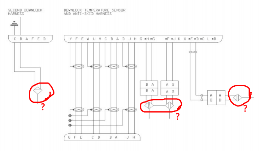

Mark, with regard to a page of WDM corresponding to main landing gear harness I have just emailed, do you have any idea about red encircled wiring symbols?
3 years 4 months ago - 3 years 4 months ago #1083 by Mark
Replied by Mark on topic MLG Harness
I have never seen that symbol before.
Do you know where the wires go after leaving the feed-through plugs at the top of image??

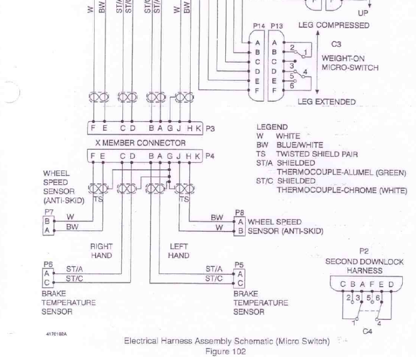

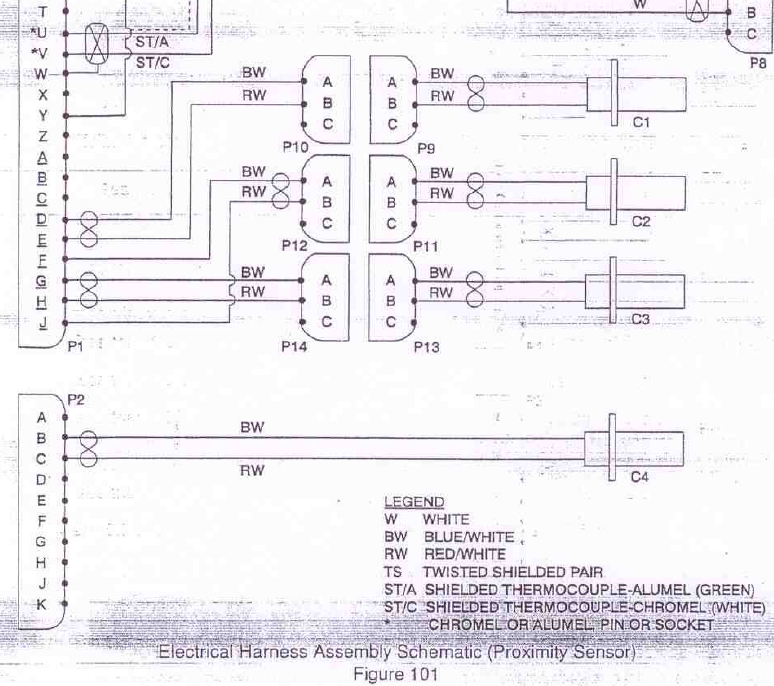

From checking your last email, it looks like those items are proximity sensors.
They're labeled as "C" items, but other than the title at bottom of page, there is no cross reference as to what they could be. The pin-outs match your previous print.
The wheel speed transducers and brake temp sensors go to different pins on the harness.
3 years 4 months ago #1089 by dynamics
Replied by dynamics on topic MLG Harness
How is proximity switch different from micro switch regarding wheel speed sensor?
3 years 4 months ago #1090 by Mark
Two completely different functions.
Proximity and micro-switches show position. Speed sensors do exactly as the name says..... output a rotational speed.
On a gear assembly there are wheel speed sensors for Auto-Bakes/Anti-Skid, brake temp sensors, gear tilt sensors (if four or more tires per gear), brake fans (if equipped), squat switches (for weight on wheels), and gear position switches (either micro or proximity).
Not all gear have every item listed above, but you can understand the amount of wiring to support all these.
You're comparing apples to oranges as far as functions go. Each item has its own use. Each item has its own wires.
