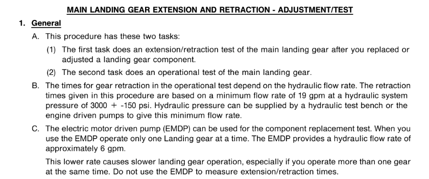

On a previous post I sent a copy of the maintenance manual that stated the electrical pump can "only" supply six gallons a minute and it is "not" recommended for raising the gear. The manual stated it can raise one gear at a time when the aircraft is on jacks.

Mark, My question is not specifically about 737 model, the issue was experienced in F27 Mk0050 for which hydraulic pressurization by electric motor driven pump is an approved ICA without any limitation so that you should normally expect both main gears and even nose gear retract simultanously , so I am asking in general whether three phase supply power quality can affect the performance of electric motor driven pump, regardless of airplane type and model?
I have just emailed MM pages.......
