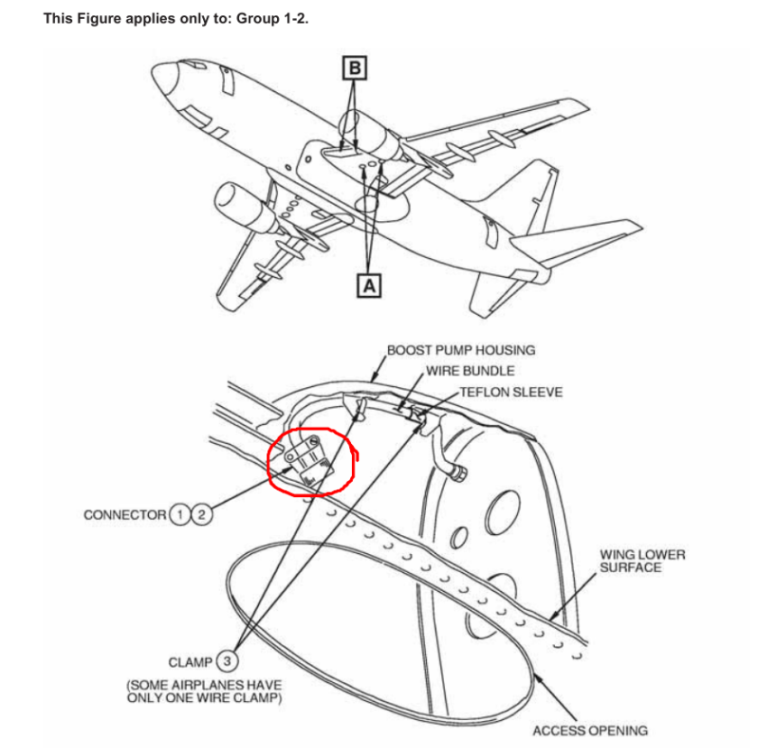

Mark, with regard to pages of Boeing SB737-28A1273 I have just sent, should contacts be removed from the red encircled connector before pulling the wire bundles, I am concern the contacts may be damaged during removal

The contacts must be removed from the plug.
If taped right, there should be no issues pulling the wires through the bundle. If one is damaged and the is extra wire to work with..... cut them all the same length and re-pin them.
