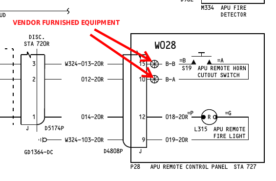

What does "Vendor Furnished Equipment" mean in wiring diagram symbols?
2 years 10 months ago #1321 by Mark
Replied by Mark on topic Wiring Diagram Equipment
Can you give me an example?
2 years 10 months ago #1322 by dynamics
Replied by dynamics on topic Wiring Diagram Equipment
I sent an email with two pages of the wdm and IPC attached. I believe the reset switch is at the point that vendor furnished equipment symbol is indicated on WDM, am I correct?
2 years 10 months ago #1323 by Mark
Those are Butt Splices. Either  environmental  or  not.
The "vendor" in this case would be your airline.
