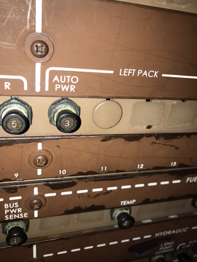

Regarding two pages I sent an email attached with, what is circuit breaker collar and when it may be removed?
2 years 10 months ago #1327 by Mark
Replied by Mark on topic Circuit Breaker Collar
Collars are installed as a solution for a inoperative or permanently disabled system.
They cannot be removed unless the discrepancy for a deferral is cleared or when engineering does a modification that requires the breaker to function.
2 years 10 months ago #1328 by dynamics
Replied by dynamics on topic Circuit Breaker Collar

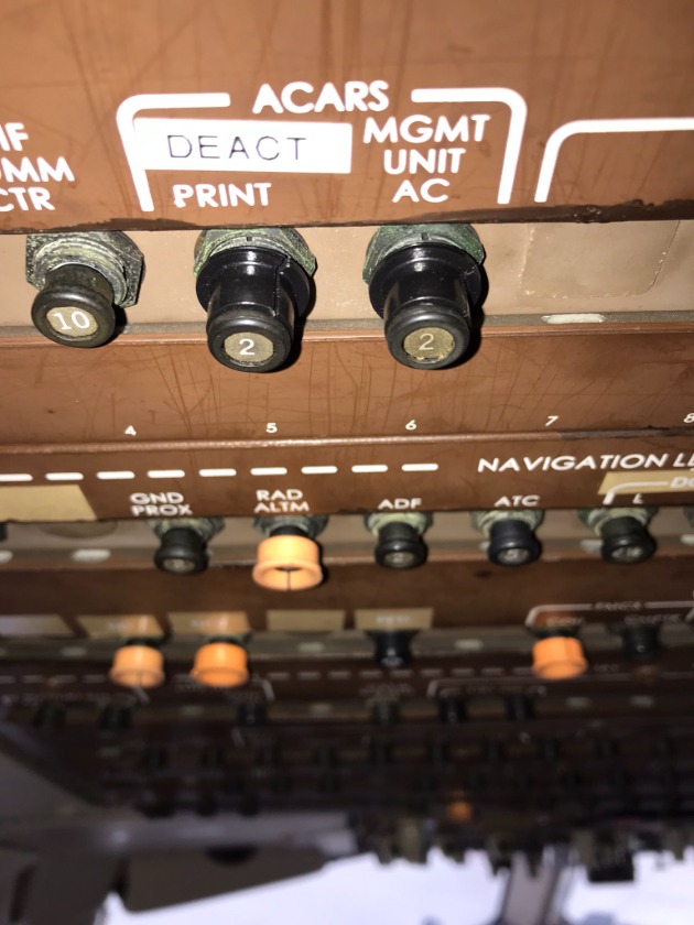

What is the difference of the cap and the collar?
2 years 10 months ago #1333 by Mark
Black, permanent collar.
Orange, temporary or breaker identifier collar.
The last one is a plug to cover a hole where a breaker was (or a spot where a breaker was never installed.
