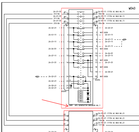

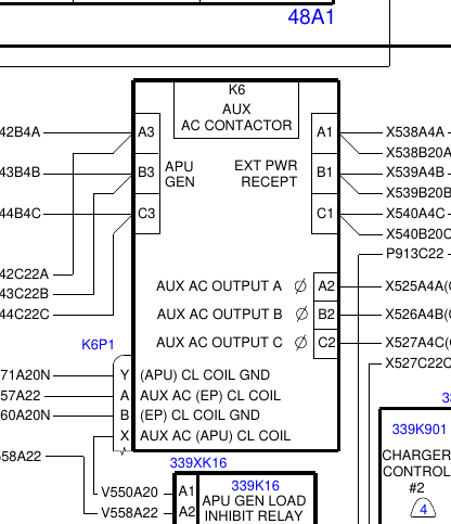

No there is not any problem I am interested to understand thoroughly the wiring design, absolutely you are right about the schematic , but I believe any relay should consists of a set of input terminals for control signals that is more likely the oil pressure signal from EAU, and a set of operating contact terminals corresponding to controlled currents that here it is more likely 115acv power supply for pitot heat, so 28vdc power supply for relay is a bit odd?!!

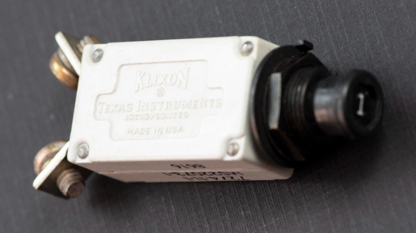

Your WDM, IPC, and Equipment List show the power contactors as "breakers".
This is a naming issue. Circuit breakers as commonly referred to are.....
Contactors (called breakers in print) are power bus connection devices.
You're getting caught up in nominclatures. Boeing calls them one thing, Airbus another.....Gulfstream another, etc....
They're all the same thing.
