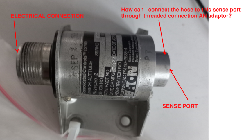

2 years 9 months ago #1363 by dynamics
I have just sent an email enclosed with picture of the switch. Would you mind spelling out how can I connect the pitot hose to the non threaded sense port of the switch through threaded AN fitting?
2 years 9 months ago - 2 years 9 months ago #1364 by Mark
Replied by Mark on topic Cabin altitude warning switch
You're making this out to be WAY more difficult than it needs to be.
You've already stated this is a #4 AN. I can tell it's a female.... even from a side view. Pitot /Static test hoses usually are #6.
You need an adapter.
You need to go to the flight-line more. This is "so" easy. Practical working skills on the aircraft is a must.... even for engineers.
If the switch has no threads and a proper adapter from the maintenance manual has not been listed then you'll need to use a chamber.....
