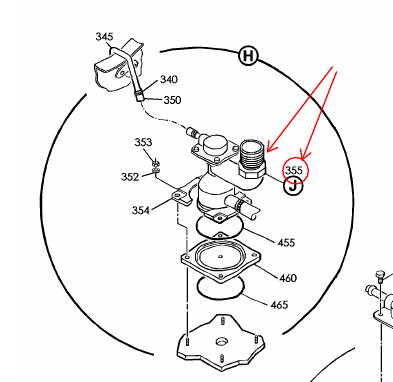

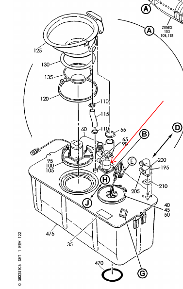

I have just sent an email with enclosed pages of the catalogue
2 years 9 months ago - 2 years 9 months ago #1373 by Mark
Replied by Mark on topic Vacuum Breaker Valve
Well..... these images show individual tanks for each toilet, so my previous guess was wrong.
I'll post the images , but without referencing the maintenance manual, I can't tell you the function of the valve.

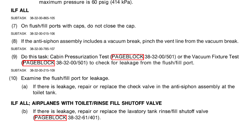

2 years 9 months ago #1374 by Mark
This is all I found from 38-32 in AMM.
