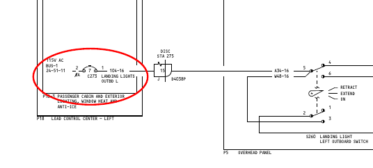

Regarding the diagram I have just sent, is the motor 3 phase 400hz?
2 years 9 months ago - 2 years 9 months ago #1376 by Mark
Single phase ("A" phase) motor. The two sets of windings you're looking at are for direction.
Last edit: 2 years 9 months ago by Mark.
2 years 9 months ago #1377 by dynamics
However it is supplied from GEN2 AC bus that I believe is three phase, by the way I have not found any three phase to single phase transformer in the corresponding diagram
2 years 9 months ago #1378 by Mark
It's just using "one" phase out of the three. Regardless of the source.
The print doesn't show three wires coming from the breaker..... only one.
2 years 9 months ago #1379 by dynamics
Is the number of C/B's the only indicator of number of phases of power supply to any element in the diagram?
