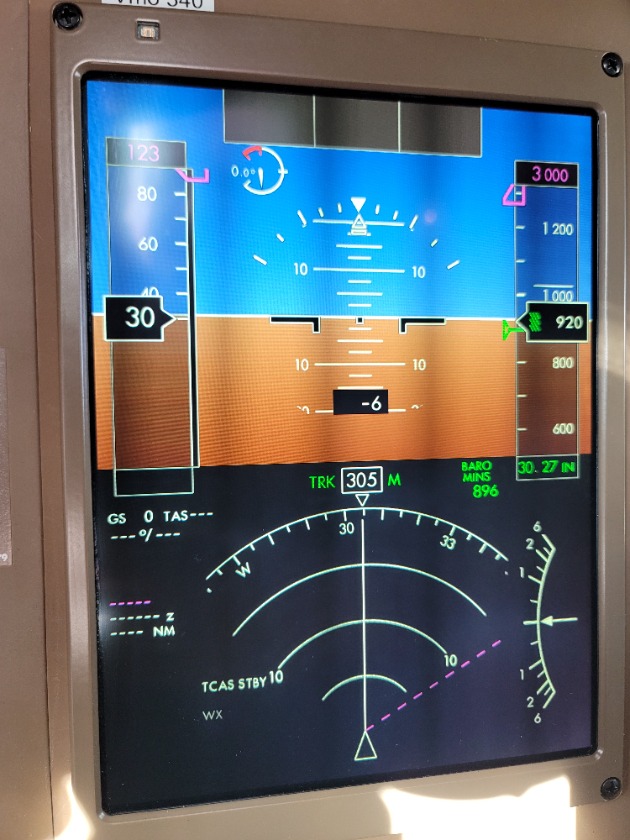

Aircraft with liquid crystal or CRT displays have the airspeed indication in the top display (usually left side). The standby altimeter/airspeed indicator is the only other source of airspeed indication.

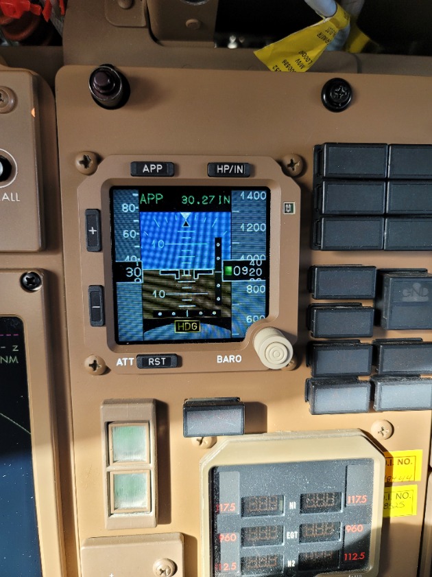

I'll see if I can get you a pick of a 767 top display for reference.

Left side of screen.
Stby indicator.
