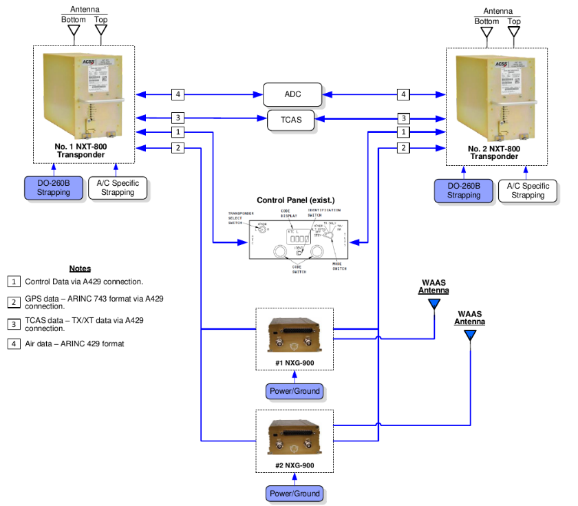

ADS-B ATC Transponders require a valid GPS position input. On some aircraft I've seen, a separate GPS receiver (usually feeding the Flight Management System (FMS) can be used to input position information to the transponders.
The NXT-800 manufactured by ACSS  use a standalone GPS receiver NXG-900.

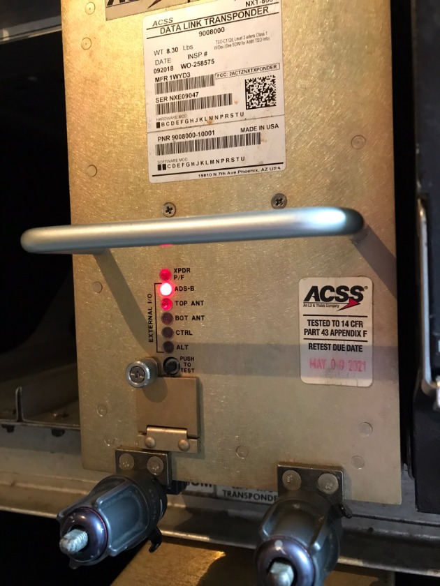

We recently had a system that was showing as failed when it was selected on the cockpit control panel. The front of the transponder showed a "ADS-B" fault light on the front of the unit.

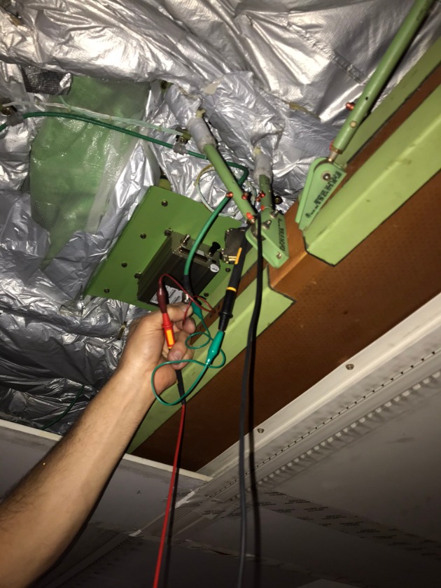

The system manual states that this failure is related to the GPS position input. We replaced the NXG-900 in the cabin ceiling which corrected the problem.

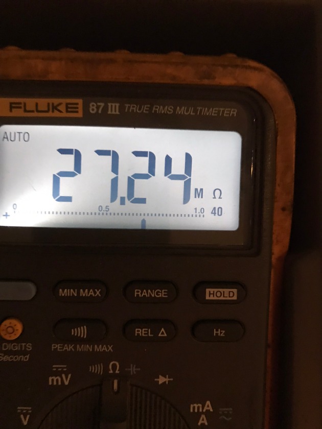

We resistance checked the antenna while we were there. Our reading was 27M Ohms. This value needs to be verified on another aircraft before we can state that this is proper for this system.
