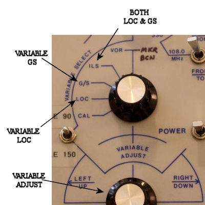

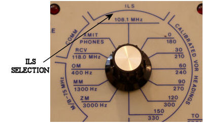

Testing the ILS system is accomplished with the VOR/ILS test box. Many different varieties of test units are used today. The basic functionality of them is the same. Most units use 108.10 MHz as a standard test frequency. This is actually the localizer frequency, but a matched glideslope output is also transmitted.
Tuning the aircraft's navigation control to 108.10 will place the receiver in ILS mode. If an aircraft is equipped with dual systems, placing both controls to 108.10 is helpful as a comparison of indications. Newer generation aircraft do not have a navigation control. Tuning of the navigation receivers is accomplished by the Flight Management System. Manual tuning is possible from the FMS control head. Honeywell FMS's have a line select key labeled NAV/RAD for inputting frequency and radial.

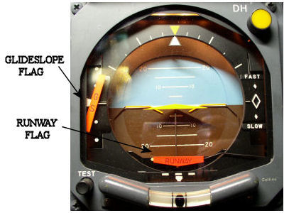

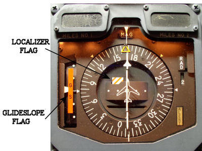

Select ILS on the test box. If the proper output is received, both the localizer and glideslope flags should pull out of view. Most testers allow for separate control of localizer and glideslope signals or both can be driven simultaneously. Full scale defections of either needle should be noted when the variable knob of the tester is used.

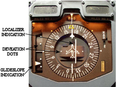

  1. ILS indication or specifically the localizer does not care about compass heading. The course knob is usually set at runway heading by the flight crew or straight up when maintenance is using the tester, but if the course was placed right/left of centerline the indication would still be the same.
  2. Localizer deviation dots usually represent 1¼ degrees each for off centerline. Glideslope dots represent 0.7 degrees each.
  3. Most aircraft installations crisscross ILS information. The captain’s ADI and F/O’s HSI showing #2 nav information. The captain’s HSI and F/O’s ADI showing #1 nav information. Comparisons between systems should always be used if two are installed.

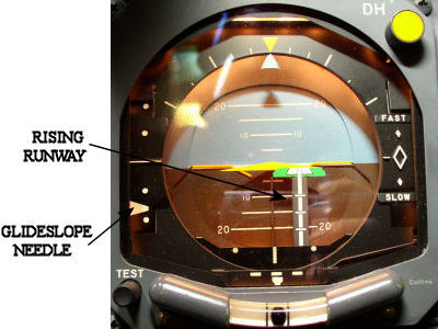

  4. The “Rising Runway” installed on some ADI’s is a dual indicator. Localizer left and right, with the dots representing 1¼ degrees. The vertical section is radio altitude, with full up representing "on the ground".

  6. The TIC30 VOR/ILS tester along with a few others allow for attenuation (decreasing) of the transmitted signal. This is very helpful when troubleshooting antenna or co-ax problems.
