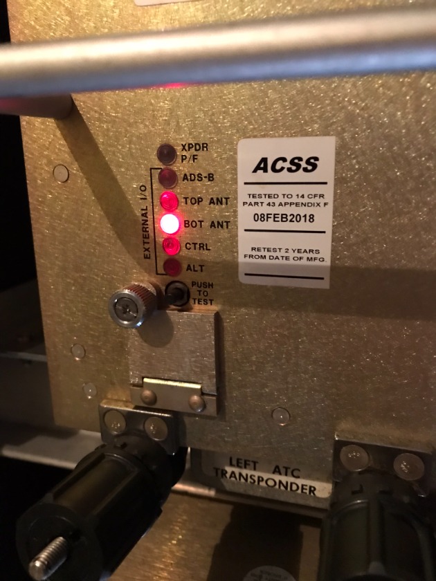

For this failure, we had a shared top/bottom ATC antenna system. Both units showed a bottom antenna failure.

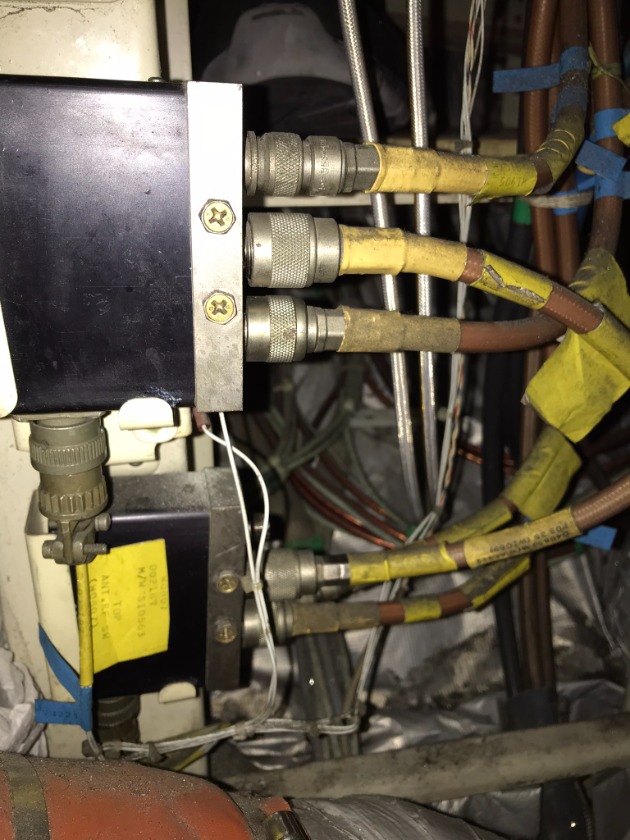

A co-ax switch (or relay) must be used in a shared antenna system. There are two switches. One switches the top antenna to the selected ATC. Same for the bottom.
We found the top connector goes to the #1 (or left) ATC transponder. The bottom connector goes to ATC #2 (or right). The middle connector goes to the antenna. Each plug type is different..... they cannot be mis-connected.

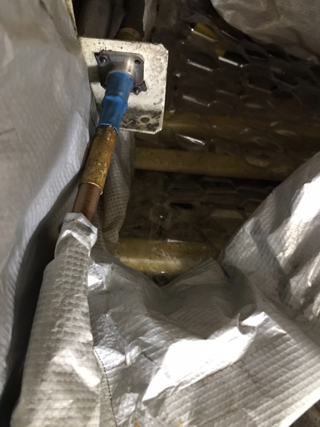

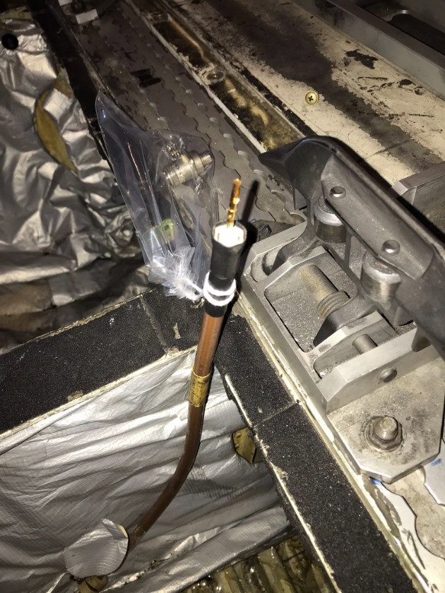

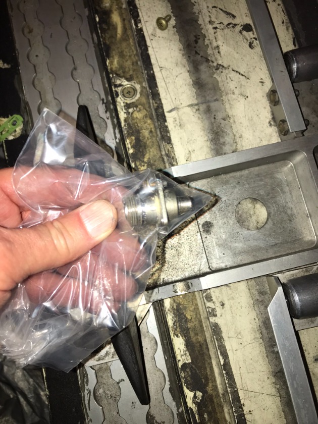

This aircraft had an intermediate plug located about 18 inches from the antenna itself. One slight pull gave us our answer.....
This is not a critical length co-ax (like a radio altimeter or TCAS directional antenna co-ax would be). We were able to replace the jack and correct the fault.
