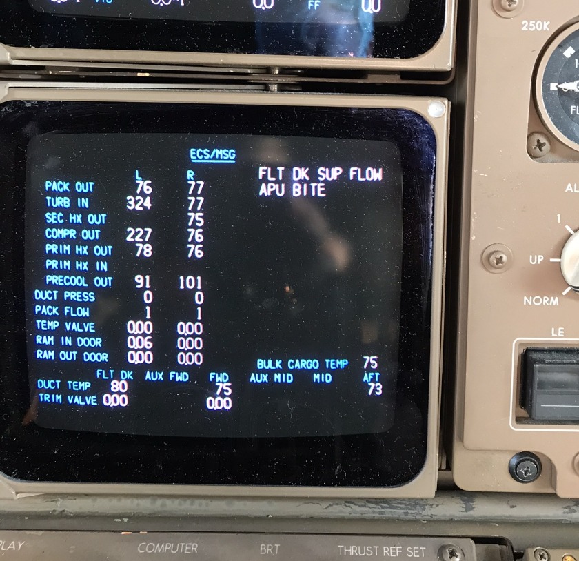

So we have a cabin dump, equipment overheat, bleed fault, and a pressurization fault warning.
Sometimes you need to step back..... get other opinions..... and put the story together. Here's "this" write-up's story.
The crew is flying a 25+ year old 767 at 41K. The ceiling on this aircraft is 42.5.
They're flying on ONE BLEED and ONE PACK @ 41k. They pull back on the throttles to begin descent and the bleed system doesn't shift to HP (from LP) bleed with the engine now at flight idle. Result..... not enough air for pack operation.
What happens? Well..... the pressurization controller goes ape-shit because the outflow valve is fully closed and the cabin pressure is going down. The equipment overheat trips because is has no flow across one of its sensors....
..... the Air System Controller senses no air flow and trips the "Bleed Fault" and the crew knows the cabin is dumping because they feel it in their ears. Was it bad enough to at least pull the masks out of the boxes??? I guess not, because they didn't. (Just ask Payne Stewart how a cabin dump worked out for him.)

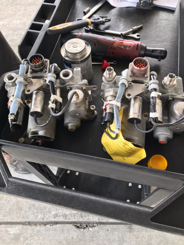

Anyway, we verified a wiring issue on the HP Bleed controller and changed it.
