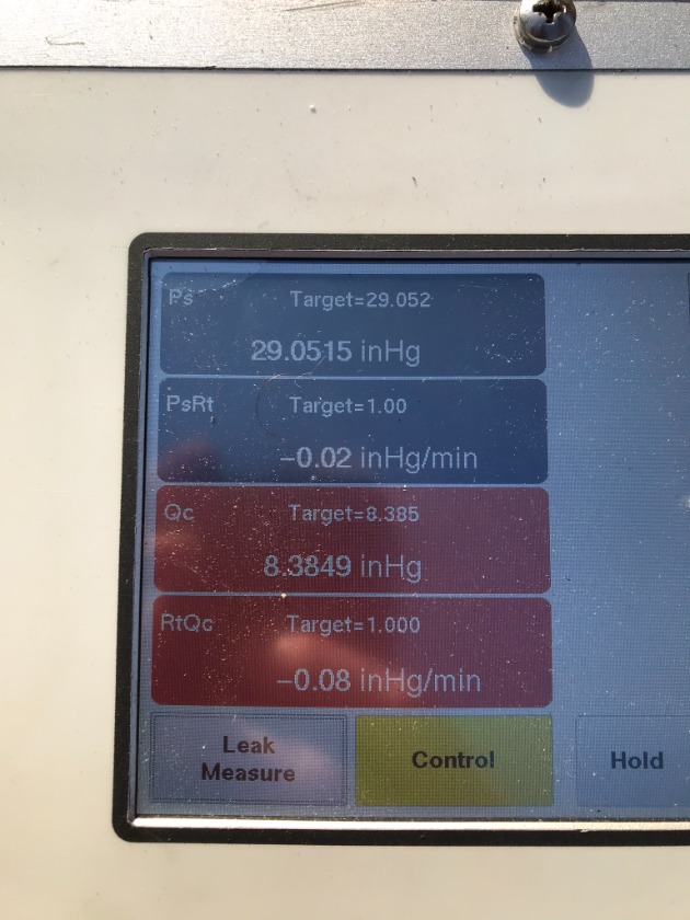

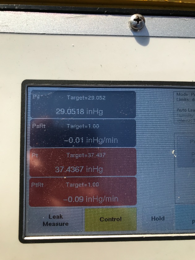

The tester shows two values for inHg, Pt and Qc. A little digging was required to find the difference.....
Impact Pressure (Qc) is the pressure a moving stream of air produces against a surface that brings part of the moving stream to rest. It is the difference between the total pressure (Pt) and the static pressure (Ps). These pressure properties are related by the formula: Qc = Pt - Ps  (From Mensor.com )

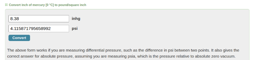

The link above is worth a look. Needless to say, we want to reference Qc. Using a online conversion, we found the value 8.38 inHg to be a little over 4 PSI.

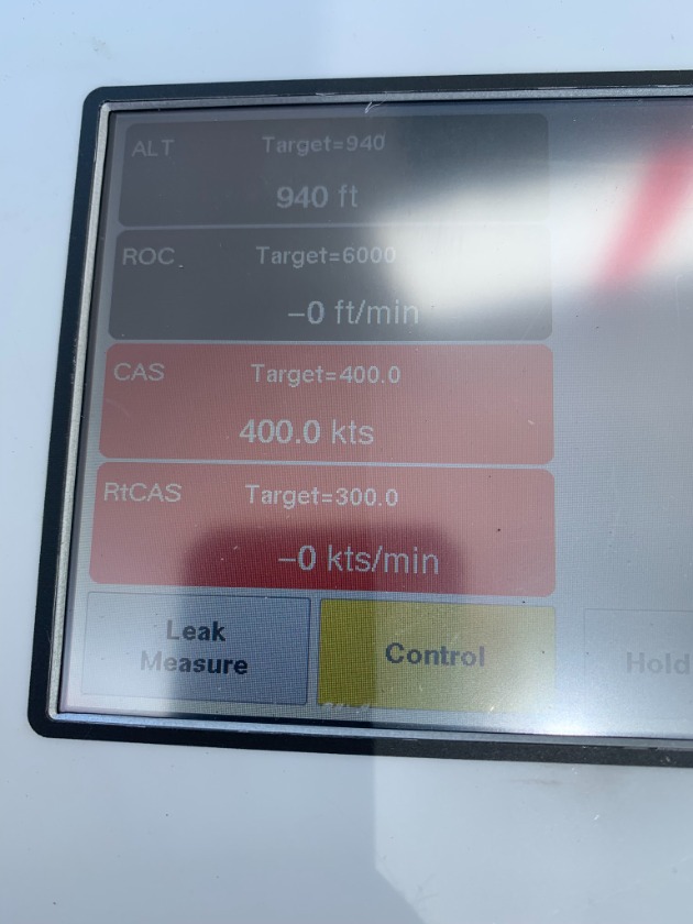

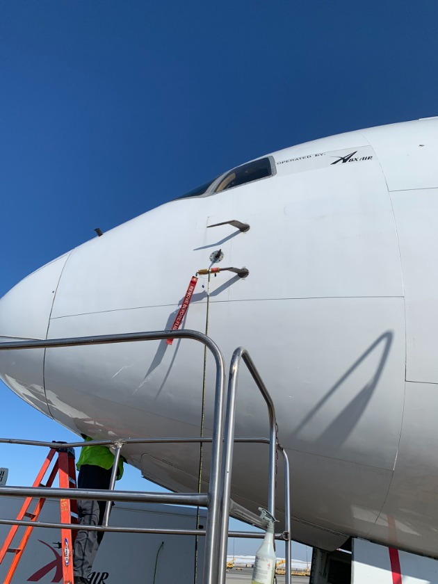

Finding these leaks can be difficult. We disconnect the Air Data quick disconnects (which spring seals the line shut) and apply pressure into the lines. We then go around spraying lines with leak detector looking for bubbles.

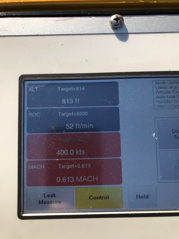

Using airspeed at 400 knots out of the Pitot/Static test box provides about (what we were guessing was about 4 PSI differential).

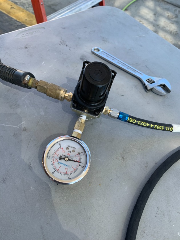

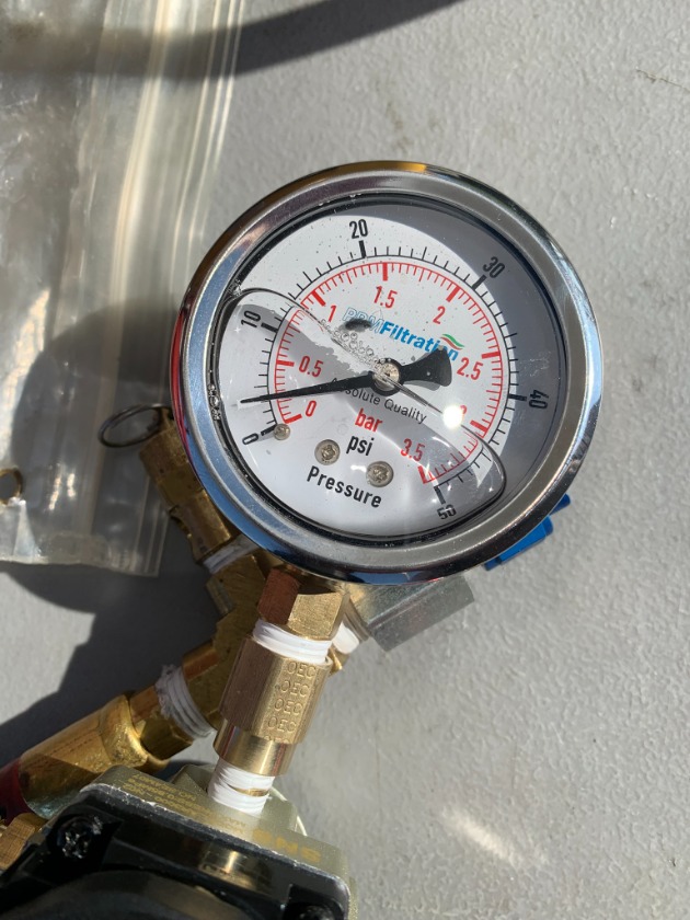

We experimented on our last troubleshooting venture. I have a low pressure regulator (something like this ) that I cranked full open while connected to the test box at 400 knots.
We had a reading of around 3 PSI. This was not a scientific, but it did show we really didn't get that much pressure out of the box.
We tried the regulator on its own with compressor air and dialed it up to 8 PSI. We could have gone higher, but for our find, 8 PSI was enough.

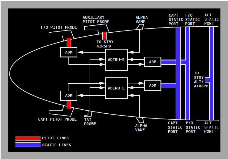

With newer aircraft..... all these lines go away. A combined Air Data and IRU unit called (of course) a ADIRU. The pitot and static ports will have a Air Data Module located near the port. This unit sends data (I'm guessing 429 data bus) to the ADIRU.

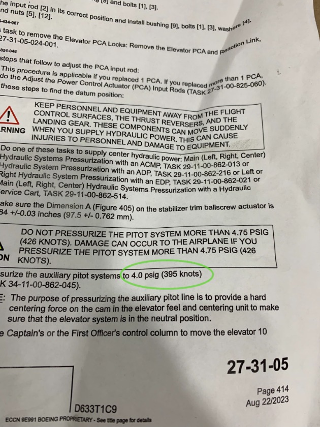

4 months 1 week ago #1892 by Mark
Replied by Mark on topic Airspeed to PSI Conversion
Found this in a maintenance manual dealing with elevator feel:
