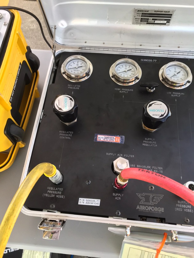

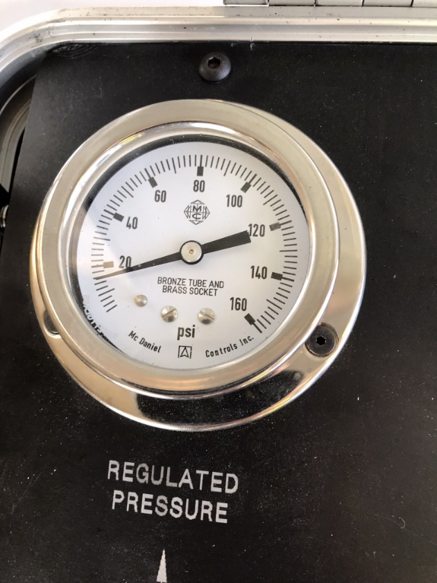

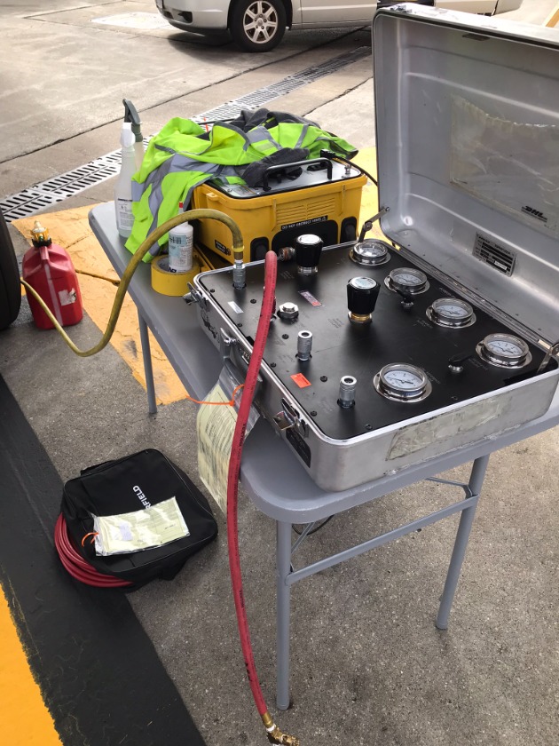

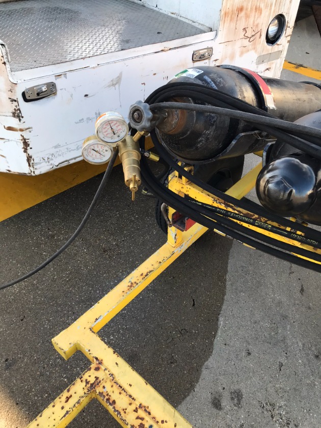

We used (100 PSI) nitrogen bottle pressure stepped down with a pneumatic system test unit. We were able to slowly bring up pressure from 0 to 20 PSI. We could have gone higher, but the leak was located within 5 minutes of using this modified procedure.
Bottle and regulator.....
Red adapter hose with 100 PSI pressure relief valve (located at bottom of image).
Pneumatic tester.....
Pressure indication.....

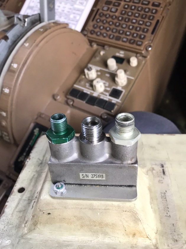

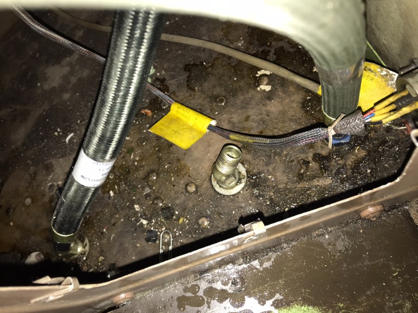

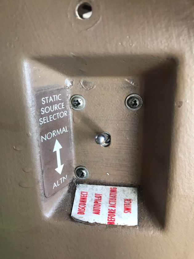

Leak found at a "through floor" fitting behind the F/O's static source select switch.
Connections at back of switch. (Most aircraft have these switches removed. Crews don't use them. They are a continual problem area because of unnecessary lines and fittings.)

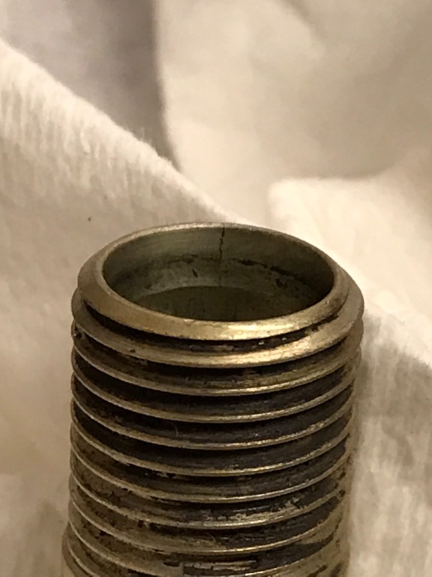

Fitting crack.....

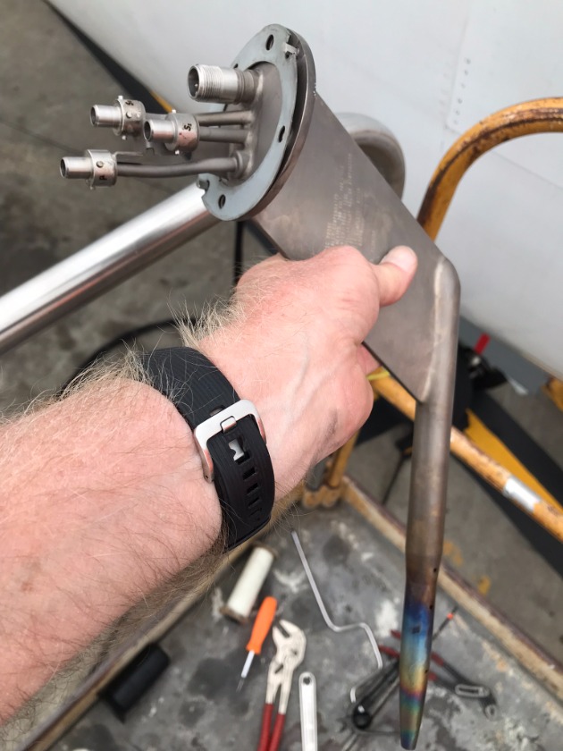

This was the first aircraft I encountered with quick disconnect fittings at the probe. These are usually flex line "B nut" connections.
