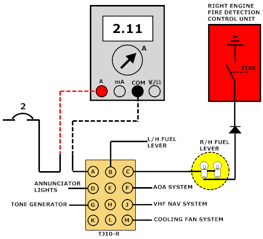

In this picture, one jumper is connected to a removed terminal block pin (main input from breaker), the other to a wire with a pin crimped on one end and inserted into the block.
Nominal value for this particular problem was less than 12mA or .012-amps.
This aircraft's actual fault was found to be the right HP fuel lever light assembly. Static current draw was 0-amps, but when the #2 fire warning was tested, the reading jumped to 2.11-amps. This did not pop the breaker. When the assembly was wiggled, the breaker popped.
After the unit was disassembled, it was found cracked internally. The positive bulb socket ring was touching the lever arm itself.
