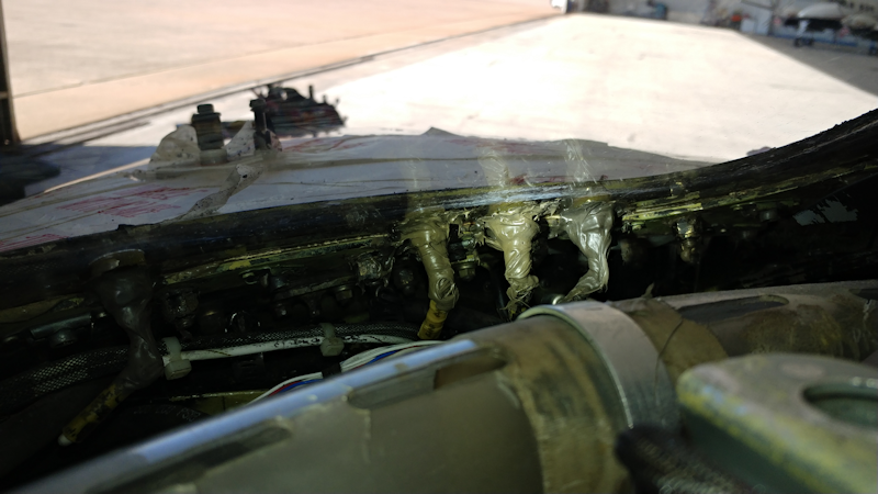

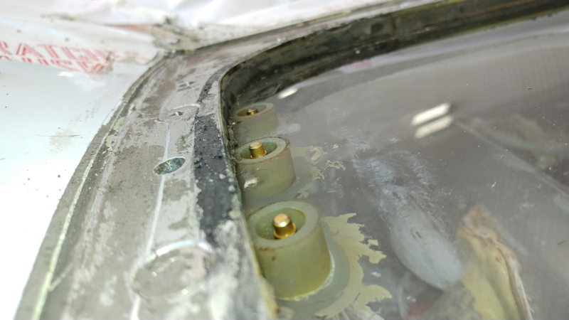

The forward left/right windows on Westwinds are actually two separate window assemblies. The inner window's main function is for pressurization. The outer, for heat. The sensor and heater elements in the outer window are connected via some unusual spring loaded points.
There are six threaded inserts in the inner window assembly. Four are used for window heat (Two separate heating elements are used). The remaining contacts are for the temperature sensor output.

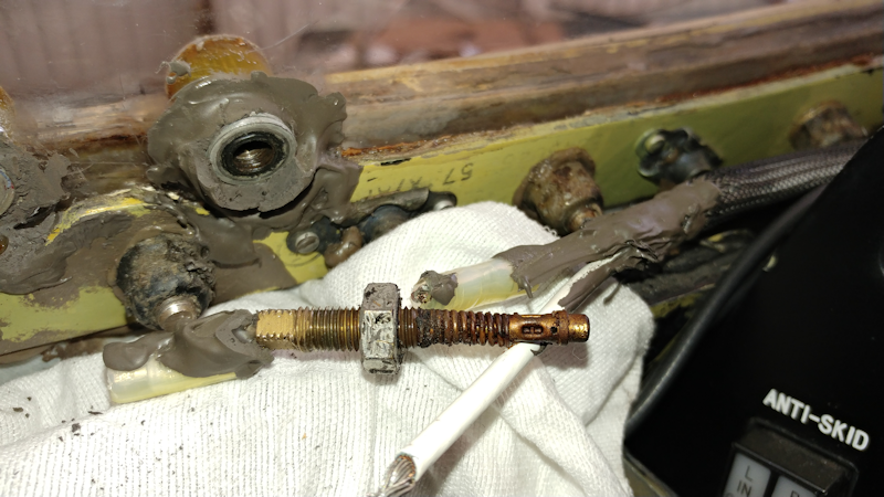

One of the (very rusted) spring loaded contacts.

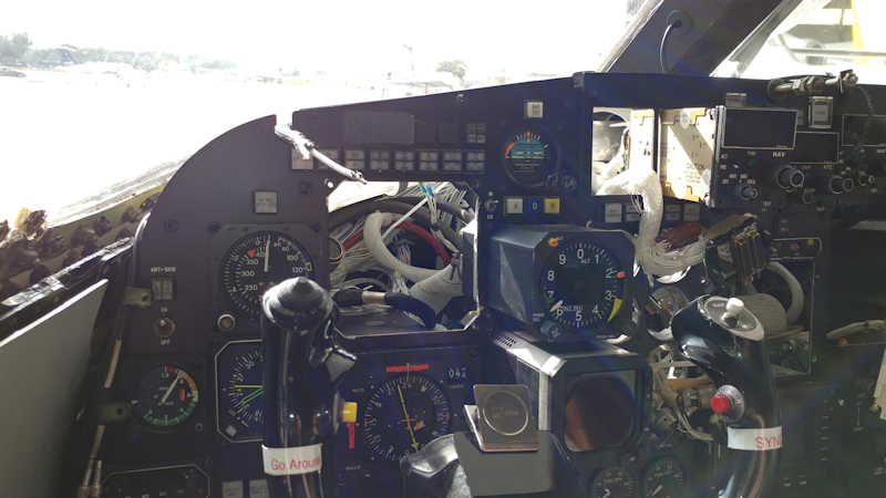

These windows use 28VDC for heat. The current needed for heating with DC is quite high. 12 gauge wire is used to carry the load. To access the aircraft connection points requires some significant gutting.

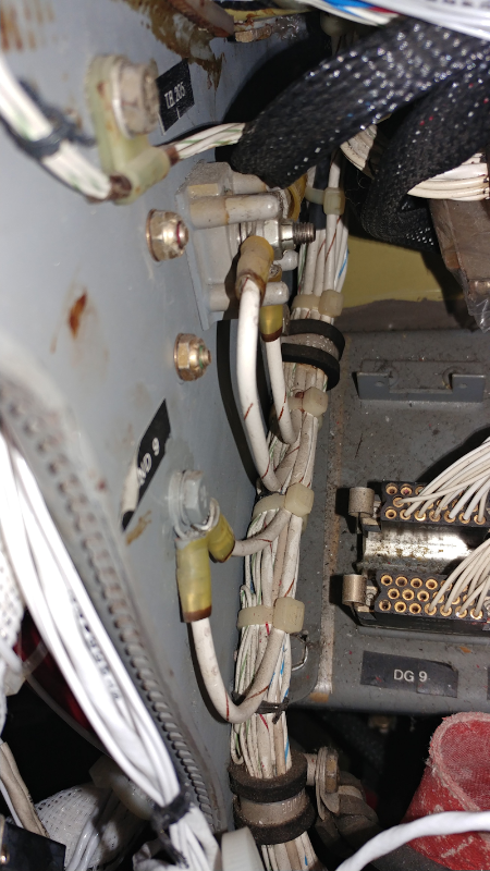

A single terminal strip is used for connecting the two heater power wires. A frame ground is used for the power return wires. This is located on the left wall of the center instrument area.

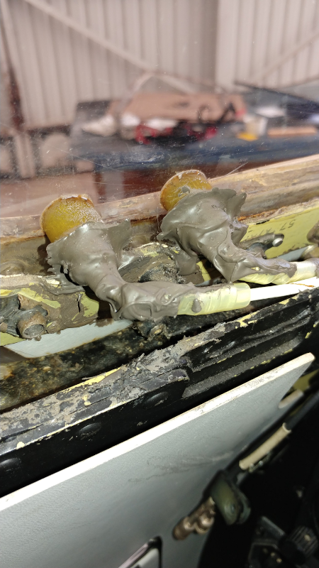

Actually, it was quite an intensive job. All the wiring runs are located at the bottom of the window. The four contacts (and wires) at the front were difficult. Everything is buried in a sea of sealant.
Glare-shield off, instruments out, and the defog duct removed. I cracked (snapped off) the duct at the "T-Fitting" where the flexible air hose attaches. It was brittle to start with. We used 5+ tubes of sealant on the install, there was plenty available for reconnecting the "T".
And...... all the damn adel clamps that needed safety wire to hold them together to get the mount bolts started. Finger strength is fading at my age.
