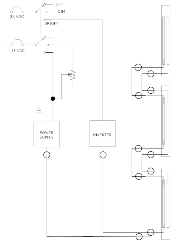

Westwind's use three sets of flood light assemblies underneath the glare-shield. It is not shown on the print, but there are two lights in each assembly.
Both lights receive the same voltage type, although the source of each input is quite different.
28 VDC is used as an input when the light switch is placed in bright. This voltage is modified by an inverter for usable light power.
115 VAC is used either at full value in bright or reduced voltage by the use of a (rather large) rheostat, when the switch is in the dim position.
In dim, only one bulb set is being used. The light intensity can be adjusted with the rheostat. In bright, both sets are used for full brightness.
It is important to note that these bulb assemblies are wired in series. A failure of the "first in line" bulb will result in all the bulbs in one set rendered inoperative.
A failure in the middle assembly will only leave the first powered and a failure in the last will only leave that particular light out. The captain's side instruments have the first assembly.
Westwind WDM 33-10-03

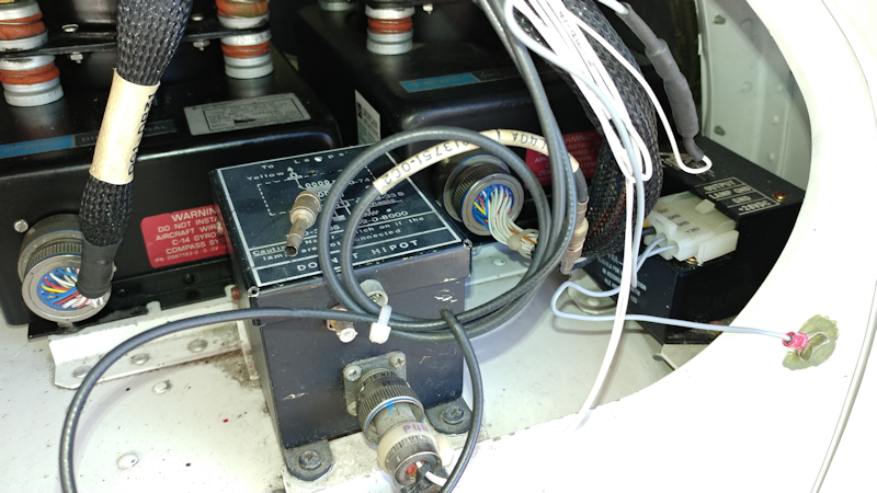

Both panel flood light supplies. View looking aft with radome removed. The inverter (image right - aircraft left) used for the 28 VDC input.
The 115 VAC power supply (image center) with a broken light feed wire co-ax.
The co-ax output wires from each unit can be swapped for troubleshooting purposes.
